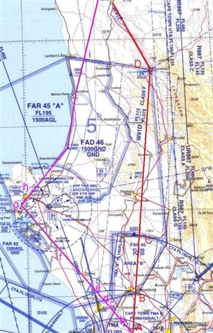

If I want to fly from Fisantekraal to Vredendal VFR and I'm outside Langebaanweg airspace, do I broadcast on 124,8 or on 126,5? The way I understand it, you have to broadcast on 126,5 when you're above 1500ft and you are outside controlled airspace and in Cape Town FIR.
And when you broadcast on 126,5, do you call Cape Town information or do you just broadcast for other traffic :? :? :? on this frequency?
For that matter, should you be flying from FAFK to the GF area you are suppose to change frequency from 124,8 to 126,5?
But when I had my training, I was flying over Diemerskraal in the GF area at 4000ft and broadcasting on 124,8. This would be wrong then, if I'm correct? :? :? (**) (**)

Postby Morph » Tue Jan 27, 2009 9:50 am
Wallaby wrote:If I want to fly from Fisantekraal to Vredendal VFR and I'm outside Langebaanweg airspace, do I broadcast on 124,8 or on 126,5? The way I understand it, you have to broadcast on 126,5 when you're above 1500ft and you are outside controlled airspace and in Cape Town FIR.
See the attached pic.
Route 1 over the mountains north of Eendekuil. Use the Red letters as indicators
Area A, 124.8 remain below 2000ft. Above that you talk to FACT and need a transponder
Area A-B 124.8 Below 4500ft ALT, Above that you talk to FACT and need a transponder
Area B-C 124.8 Below 1500ftAGL, 126.5 1500ftAGL-12000ft ALT, Above that 122.5 Langebaanweg
Area C-D 124.8 Below 1500ftAGL, above that 122.5 Langebaan weg
Area D to Vredendal - 124.8 below 1500ft AGL, 126.5 above
The purple route, if you don't want to go over the big klippe and it's much more scenic via Saldanha
A-b 124.8 remain below 2000ft. Above that you talk to FACT and need a transponder
b-c 124.8 Below 4500ft ALT, Above that you talk to FACT and need a transponder
c-d 124.4 FAD200, below 4000ft
d-e 124.8 Below 4500ft ALT, Above that you talk to FACT and need a transponder
e-f 124.8 Below 1500ftAGL, 122.5 Langebaan Weg
f- 3nm from g 122.5 Langebaan approach
g Salndanha Airfield 122.7
once leaving Saldanha, h-i, 122.5 Langebaanweg
i-Vredendal 124.8 below 1500ft AGL, 126.5 above
see not complicated at all :wink: :lol: 8)
NOTE: Generally speaking any area where you are going to be talking to CTinformation you should have your Altimeter set to 1013.25
First you call with something like, "Cape Town Information good morning" If they respond then tell them who you are, where you are, what altitude and where you are going. They are lekker people and have even kept us up to date with the rugby scores on the way to Carnavon :lol: 8) . If no answer, then broadcast as per normal on 126.5 the same information. Sometimes if you are very low, they will relay messages to you via another aircraft.
124.8 untill you enter the FAD200 GF. Remain below 2000ft if in TMA "A" and below 4500 TMA "B"
Fisantekraal to Vredendal1.JPG (52.76 KiB) Viewed 1709 times

Thanks Morph,
This does clarify a lot for me, and looking at it, it's not that difficult. It's only when this boertjie start gooi'ing the English language that my tong starts gettin' into knots.....eish (**) (**)

Morph, now you’ve done it. I am now totally confused with your “redline route” Maybe I have a very old map?
We must get together so that you can show me how.
Re: Radio calls - questions ?
Postby Morph » Tue Jan 27, 2009 2:49 pm
Good Idea, when are up at the airfield again, maybe sat morning
