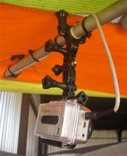

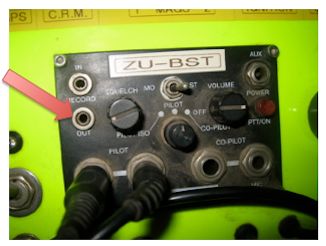

(Sorry for English)pit bull wrote:dag almal,
hoop die jaar is n mooi jaar vir almal, dit het baie goed begin vir my. het na manny se wilds plaas toe gevlieg op die 01/01/2014
so die eerste keer wat ek '''2014'' geskryf het was in my log-boek.( noord-wes van makoppa ) thabazimbi distrik. 1.3uur van eagle's creek.
nou soek ek hulp asb. kan iemand my se hoe kan ek my gopro se mikrofoon op- Koppel so dat wat ek se op die radio & intercom, op geneem kan word op die ''vidio'' van die gopro.
sal dit waardeer as iemand kan help.![]()
groete
pit bull.
It really is extremely simple. Take a 3.5mm audio cable from your intercom to your GoPro! In that way you pick up all radio comms and intercom chat.
Most intercom systems have an 'audio out' socket, which is where you need to connect to (see foto below).
I then take this feed through my wing to the GoPro (see foto below). In the configuration shown using the GoPro casing, a. You will need to drill a hole through the casing to allow for the audio cable to connect into the GoPro camera, and b. Your GoPro has to be configured to record inverted (setting on GoPro).
Taking a microphone into your helmet would allow you to ONLY pick up PIC talk, thereby missing out on PAX-speak and radio comms (other than PIC-TX).
