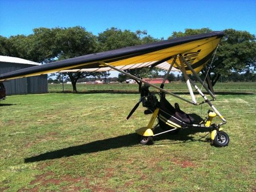

witchy woman, aka ZU - DLP.JPG (89.46 KiB) Viewed 2364 times
