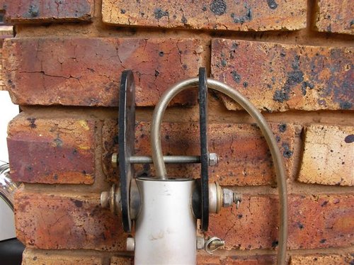

FYI . . . here is a picture of a typical hang block (Aquilla), showing TWO rotations of the Safety Cable - with ONE rotation on FRONT of the Hang Block.
Also, safety cable bolt points are aligned with hang bolt, so there would be no rotation of the trike airframe in relation to the wing on failure of the hang bolt.
Hang Block, showing TWO rotations of the Safety Cable
Hang Bolt & Cable.jpg (28.85 KiB) Viewed 1209 times
Just to clarify, the hang-bolt is the TOP bolt in this picture.

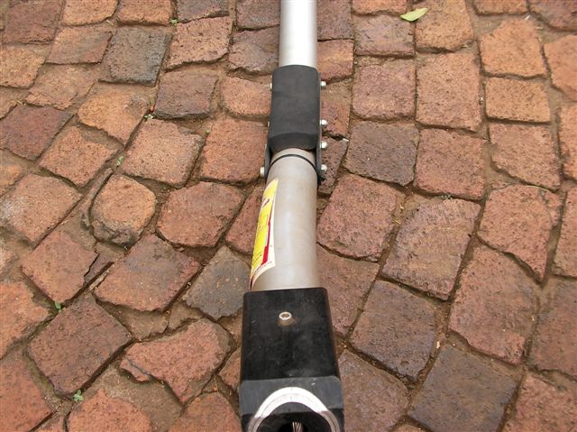

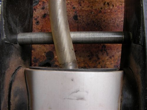

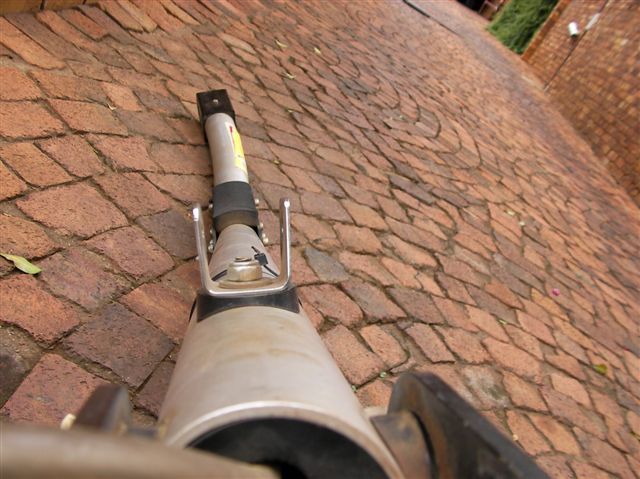

As far as I can tell from the above, your calcs are based on the shear strength of the bolt. But I am not really worried about that...rather the shear strength of the Aluminium through which it passes.... have a look at the photo's below...That bolt will prob never break (even at 12g??)... but your whole life rests on the integrity of the 30mm (approx) of aluminium tubing above it. The Alunimium will shear long before the bolt does....thus my post regarding the wear and tear on the pylon bolt hole. (^^)
Here.... have a careful look at the nylon bush starting to stick its head out of the pylon... should be flush! Hole elongated by approx 1mm, thus allowing the nylon bush to protrude. This was not accident damage (even though the RHS appears to protrude more)...when we did our ATF in Nov, Hans called me over and showed me the gap. At the time, he said we would prob have to replace the pylon soon....I didnt think he meant the whole trike!!! :roll: ^
Here are just a few more of how stuffed the pylon is.... :wink:
