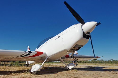

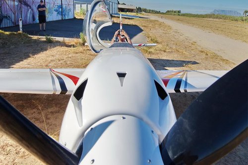

I think it really looks good with that long nose - gives it a 'fighter' quality!
Here are some more shots highlighting that nose.

That long nose coupled with the undercart positioned so far back, looks to be a good recipe for a nose over.
Would one get more aerobatic bang for the buck with an older Pitts / Zlin 50? (Price Range R350 - R600K)
What would an MPI cost for one of the above aircraft vs AX?
Fuel burn on Pitts / Zlin vs AX?
Would an AX be suitable for low hour pilots, or would plenty hours on a tail dragger Bush Baby be required?

The big difference between this machine and your older pits/Zlins etc will be in the running costs. No annual inspection, No megga dollar TBOs to scare you and it will be owner maintained AND will have a mo=gas fuel burn of approx. 20l/h vs 40-60!
From what I gather as a tail dragger it is a very easy machine compared to a bushbaby. Donald says it is much easier than his previous Rans-S10 for example so the tail dragger aspect should not scare away any competent pilot.

I also like that long nose for both aesthetic as well as practical reasons. Please allow me to shamelessly but temporarily hijack you thread.
You mentioned Bushbabys being a handfull as tailies. Regarding the older ones this is indeed the case. The cause is that for some inexplicable reason the old manual dictated that they be built so that the empty CoG fell within the operating CoG limits. The result was that as soon as you wanted to use the airplane for what it was built for, one had to put the fuel in and climb in, thereby pushing the CoG too far towards the aft limit.
Whilst this condition is not a problem as far as flying goes, it tends to make any short coupled tailie a handfull on the ground because one constantly has to take action to prevent the mass behind the main wheels from overtaking them on the ground roll.
These days we build Explorers and Safaris with longer noses for this very reason, when empty, the Cog is forward of the envelope, put a pilot and a bit of fuel in and it is just on the forward limit, load it to MAUW and it is at the aft limit.
The difference in ground handeling is like night and day compared to old and they also handle better in the air with a heavier nose.
