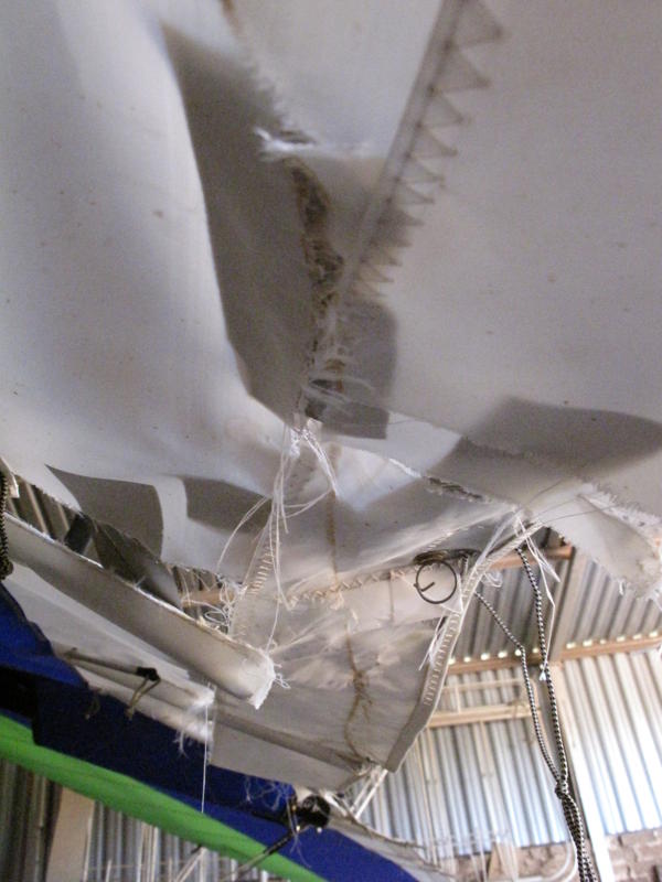

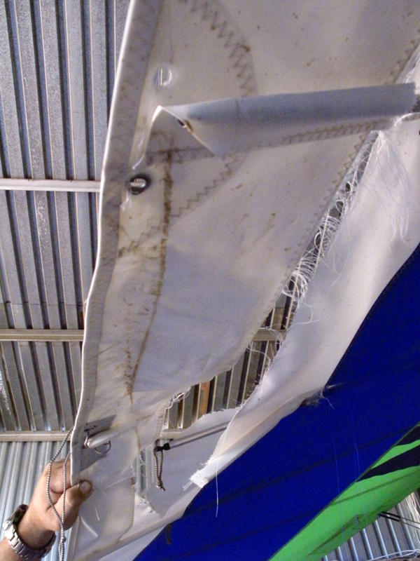

was that from one shot?? . On the other side you are very lucky to be alive as when a trailing edge rips you loose alot of tention in the wing on the one side and can cause a catastrophic failure. You were looked after by a higher power thats for sure! How did you know it was a bullet hole? Looks almost like something went through your prop and then that hit the wing
EL MEXICANO
Posts: 94
Joined: Mon Apr 06, 2009 7:08 pm
Re: EL MEXICANO SHOT AFTER LANDING
Postby EL MEXICANO » Tue May 18, 2010 7:43 pm

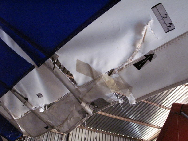

THE BROWN MARK IS WHERE THE BULLET BURN THE CANVAS AND BROKE THE 3 RIBS, THEN THE TRAILING EDGE FALL AND THE PROPELLER PULL THE CABLE AND TEAR THE WING ,AND THE PROPELLER GOT DAMAGED BY THE CABLE.
THE POLICE FROM THE FORENSIC SCIENCE LABORATORY SAYS THAT IT IS DEFINETLY A BULLET :
BECAUSE BURN THE CANVAS(THE BROWN MARK IN THE WING IT IS NOT STAINED , IT IS BURNED)
THE TRAYECTORY WAS COMPLETELY HORIZONTAL .
THE BIG BANG HEARD A KILOMETER AWAY ,
WHERE THE BULLET WENT OUT IN THE CANVAS IS A TYPICAL HOLE OF A BULLET.
THE STICKERS OF THE FORENSIC DEPARTMENT SHOW THE DIRECTION OF THE BULLET ,AND WHERE THE BULLET WENT THRU THE CANVAS.
PLUS THERE WAS NO DAMAGE IN THE PROPELLER FROM A STONE, ONLY THE ONE MADE BY THE CABLE WHEN THE PROPELLER PULLED THE CABLE.

Holy Shit!!!! and did you flying to the ground like that?? my god you are sooooooo lucky!! I now see what you mean, the bullet hit a luff line and that came down and then cause your prop to hit ity once on the ground right??

For a long distance shot, that impact point comes pretty close to head hight region....... wonder if they were aiming at the trike or the pilot/pax
