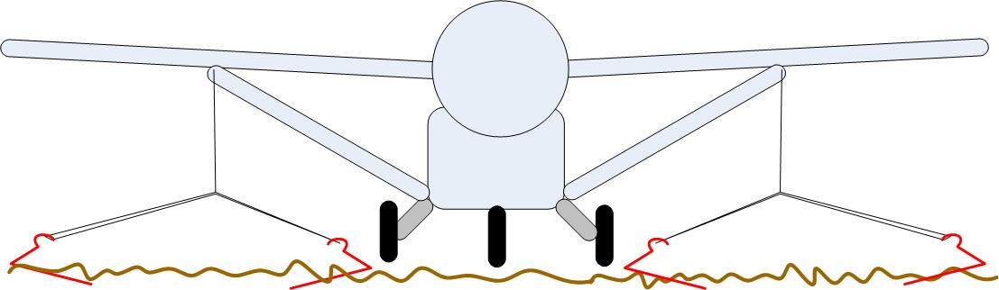

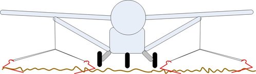

Postby Morph » Fri Oct 16, 2009 10:54 am
Excuse the rudimentary pic. I do this, two tent pegs per wing, then one front and one back

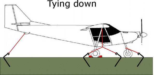

Postby John Waterson » Sun Jun 20, 2010 6:22 am
This works for me. Make sure that the tie downs are attached to a point that will not flex the wing struts.

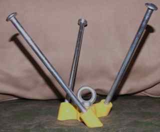

Postby ZULU1 » Wed Jun 23, 2010 7:00 pm
OK, In response to Dish and having spoken with him today, we have tooled for a similar device, now we need a local supplier of the pins, they are 270 mm long 10mm diameter and pointed one end with a forged button head on the top. Most probably its the same pre form used before a hex head is applied. Most contacts I have made are limited to 150 mm capacity. Any body on the forum know of a manufacturer capable of producing pins to that length and specification?
We made the first sample today and have used the resources of "Ing" John Young.
Many Thanks Paul
ZULU1
Posts: 1339
Re: 3 Axis Tie Downs??

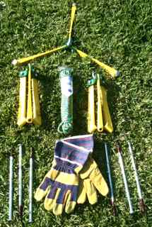

Postby ZULU1 » Mon Aug 23, 2010 6:04 pm
As promised here is the mini Grippa and its big brother the Grippa. A perfect set for a trike is 2 x Grippas for the wing and 2 x Mini Grippas for the front and back. For a three axis 3 x Grippas will hold anything down.
Made in Ballito
Zulu1
Mini Grippas
Mini Grippas.jpg (8.2 KiB) Viewed 1228 times
Big Brother Grippas
