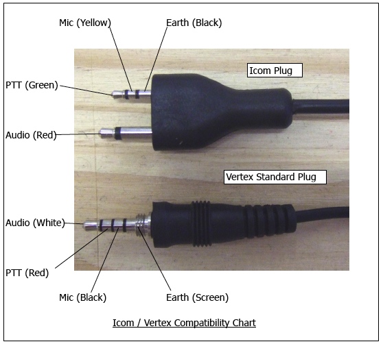

OK..For those chaps that wish to import and convert from Icom to Vertex Standard (only the VXA220 and VXA710) I attach a picture of the connections of the two plugs. We make the Icom Plugs ourselves and I advise our colours which are the same as Icom standard. Various items have been imported over the years and no guarantee on the Icom colours supplied.

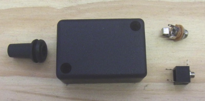

The Vertex plug is the same as what is supplied with the radio. THE CT91 adaptor from Vertex is not the same, beware of that product. I attach a picture of the components that may be purchased to home make an adaptor.
Simply cut off the two GA sockets supplied with the radio, purchase a small housing a 2,5mm stereo socket a 3,5mm mono socket and a small grommet. Solder to the configuration and thats about it. The radio performs the same as a Icom ICA3/22, 4, 5/23 series. The pitch is exactly 10mm.
We change Airmagic chatterboxes at no charge, just send us the plug and cover the cost of postage.
Remember when using with other systems, set the side tone to ST1 and the ANL must be on. Air MAgic and Lynx no need.
So in short a economical answer to old radios is import direct, then head off to nearest electronics supplier to make the adaptor. Maximum about R50,00
