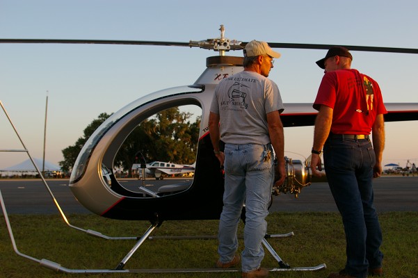

Postby DieselFan » Tue May 15, 2007 11:04 pm
I'm a correct in saying under 200k for a chopper!
http://www.innovator.mosquito.net.nz/mb ... A_Wadv.asp
http://www.google.co.za/search?hl=en&q= ... rand&meta=
Wow that is cheap?
Length: Frame 16 ft., Overall 20 ft. Width: 72 in., Height: 84 in.
Rotor Diameter: Main 19.5 ft., Tail 40 in.
Empty Weight XE: 298 lb
Empty Weight XEL: 312 lb
Gross Weight: 610 lbs
Useful (Pilot) Load: 240 lbs.
Fuel Capacity XE: 12 US gallons
Fuel Capacity XEL: 5 US gallons (as required by FAA Part 103, Ultralight Regulations)
Engine: Compact Radial Engines MZ202, 2 cylinder, 2 stroke, rated 64 HP (45kW)
Electrical System: 12 volt DC battery, starter, 180 watt alternator
Rotor Speeds: Main 520 rpm, Tail 2500 rpm
Fuel Flow at Cruise: Approximately 4 U.S. Gallons per hour
Flight Duration XE: Approx. 140 minutes depending on conditions, loading, speed, etc.
Flight Duration XEL: Approx. 60 minutes depending on conditions, loading, speed, etc.
Performance: Hover in ground effect: 8,000 ft. (estimated)
Hover out of ground effect: 6,500 ft. (estimated)
Max Speed: 75 MPH
Some assembly photos

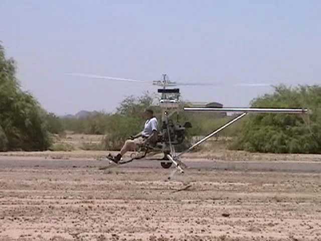

Postby DieselFan » Tue May 15, 2007 11:06 pm
and can be ordered without fairing
