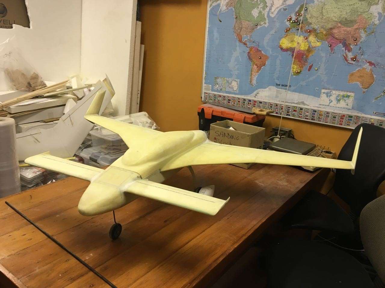

If someone can tell me how to upload a picture ill send one of the "little easy". She's a beauty in her own right.

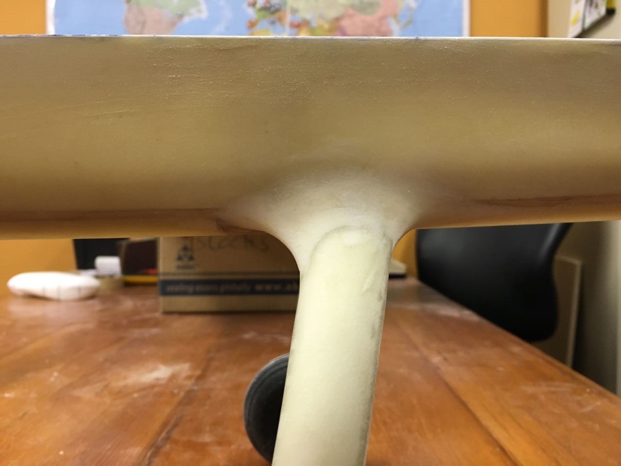

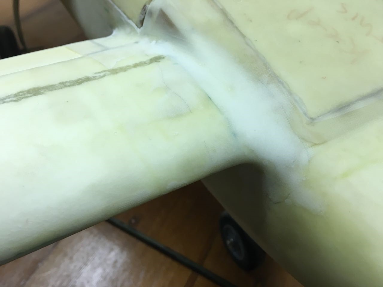

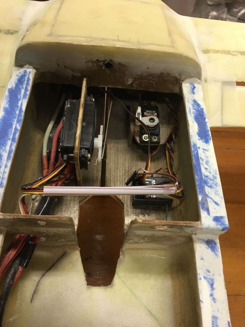

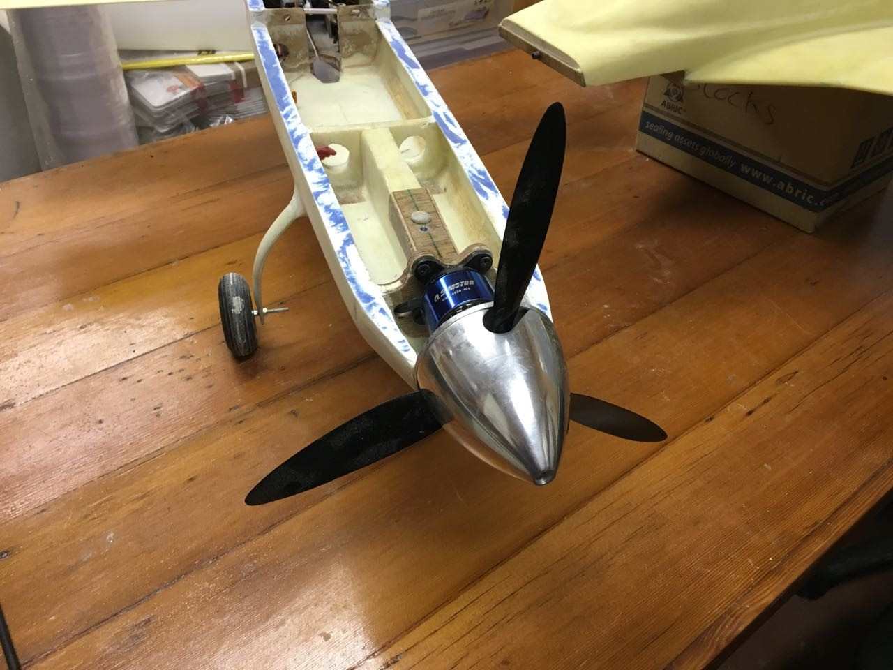

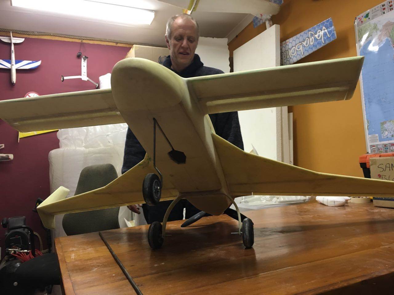

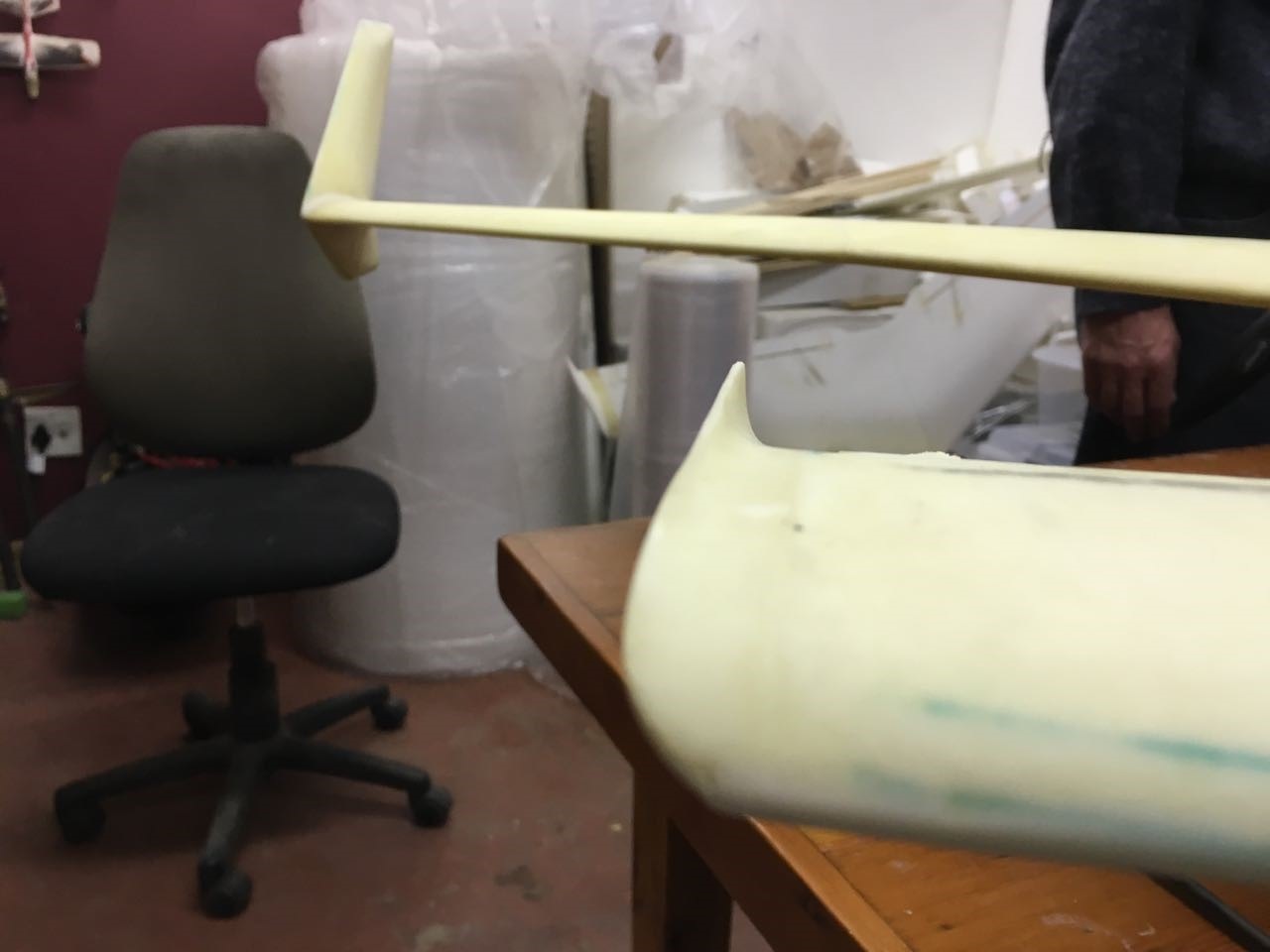

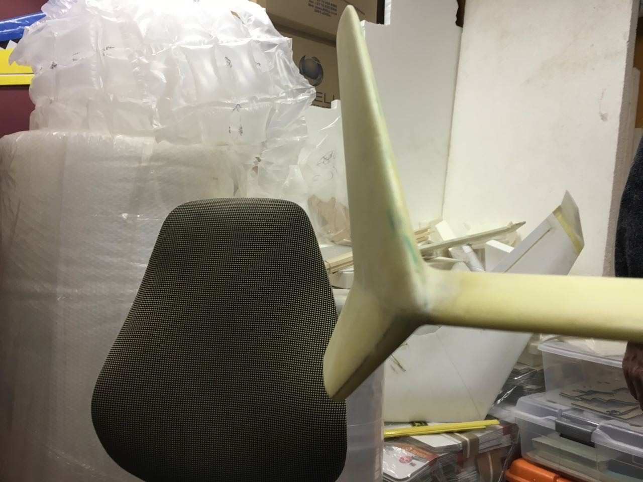

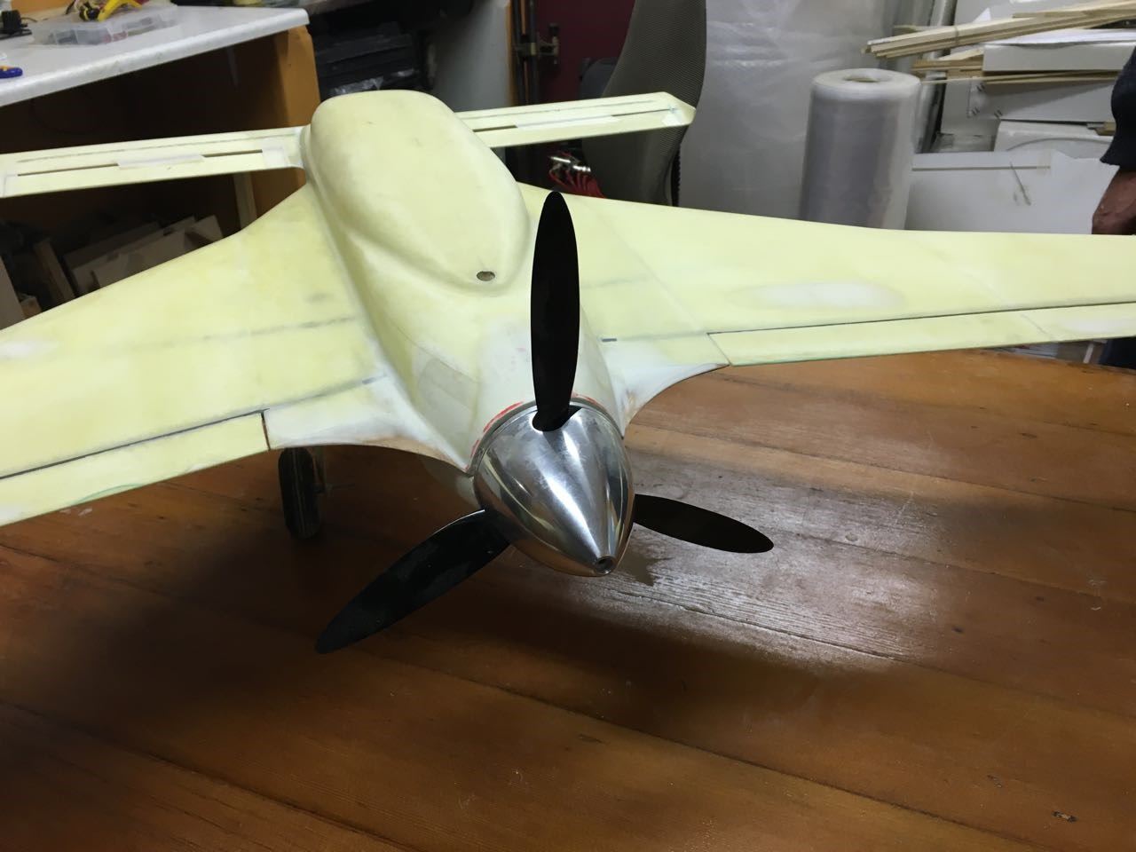

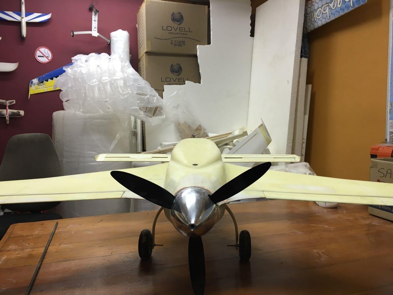

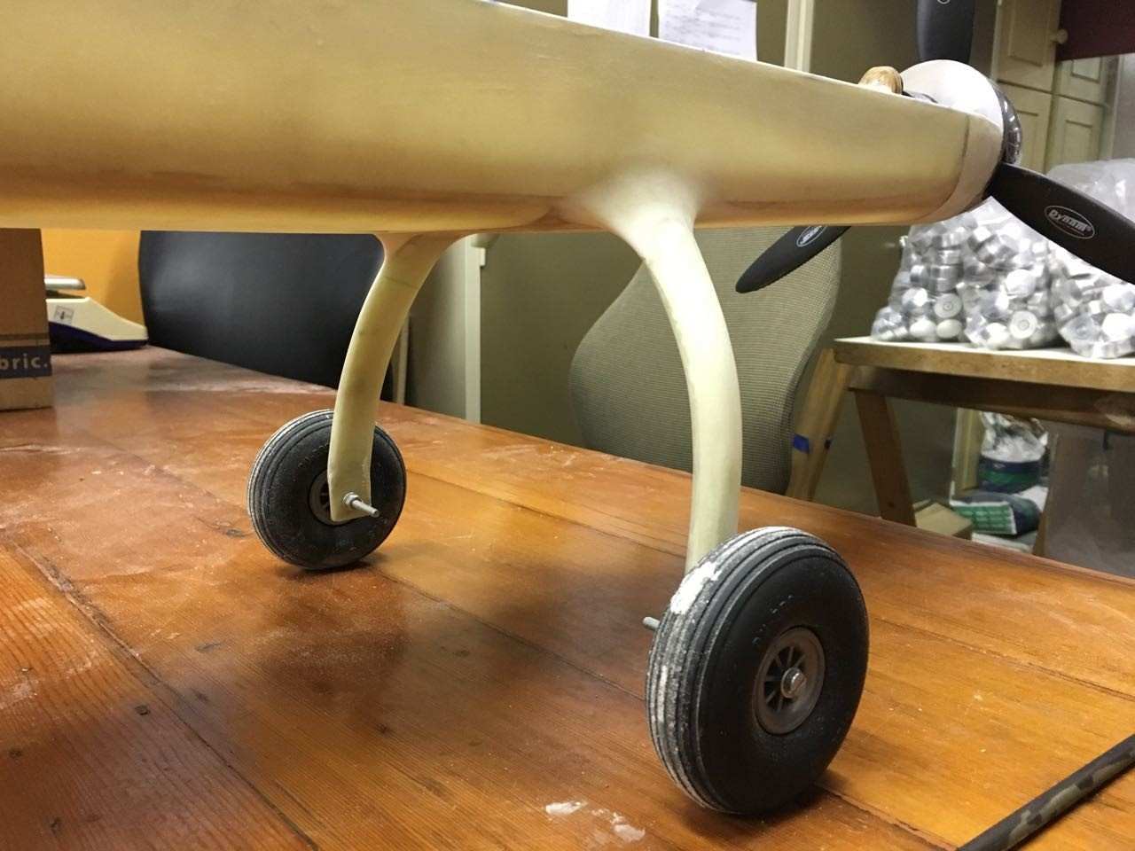

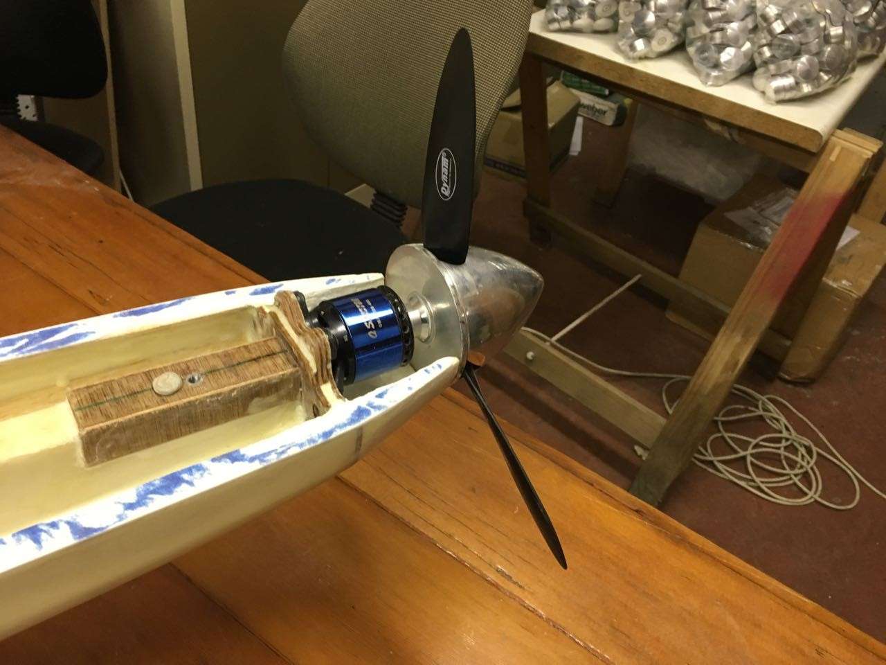

Some photos from The Buzz:
Re: Building the Long EZ
Some more:
Final batch of photos from The Buzz:
