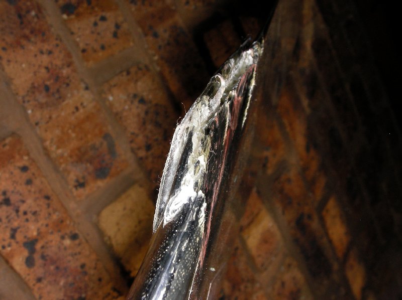

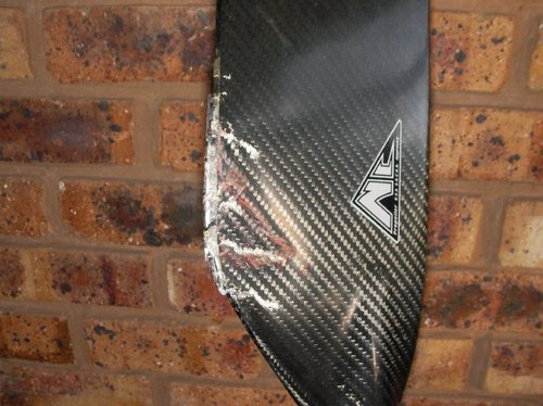

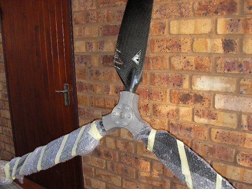

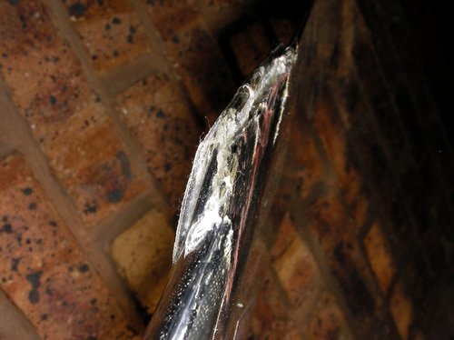

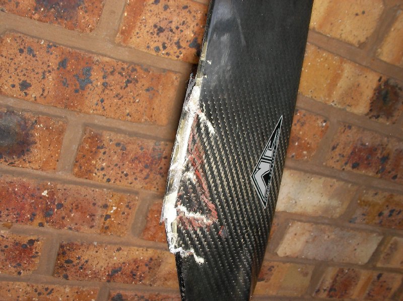

Pic's of the prop damage....off to Nigel Coutts tomorrow morning to replace the blade, re balance and set the pitch as we had it....will just have to bolt it back on and do a test flight or two to test the settings. Going to replace the bolts...I'd rather just fit new ones.
I cant find my bloody torque wrench
....may have to borrow one from somebody when I re fit?

Alan, if all else fails, my prop is not doing anything....you are welcome to borrow it. Just torque the bolts 22Nm.
