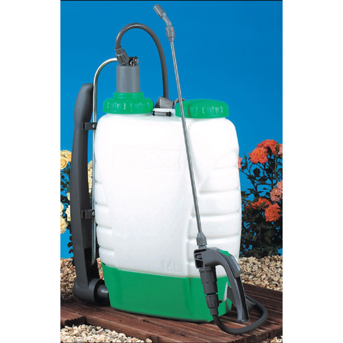

What about considering a 20 lt pesticide back mounted sprayer?
Besides being solvent compatible, it appears to have all the plumbing required. Just add a small stopper, similar to the IV drips, which you can open in-flight?
Cant seem to load a pic, but they wholesale for around R250.00

The reason why I proposed the 'pesticide sprayer' application is because it has a plunger to initiate the pressure and a trigger/ forcet mechanism. Just remove the nozzle and fix to the fuel tank lid.
