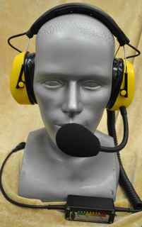

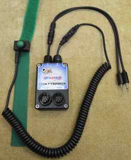

I attach a picture of a Nomad headset, this has no means for any battery to go flat as its switched externally as the batteries are in the cable and uses a Binder plug, allows a massive reduction in weight of the headsets and has a battery level indicator built in. Takes 2 x 1/2 AA batteries at 1200mah and they are super light. Not available for the Alpha chatterbox series. Battery life is over 150 hrs.
Used with a Nomad series chatterbox
Nomad headsets.jpg (9.49 KiB) Viewed 1741 times
Simple Nomad series chatterbox with Binder plugs
Nomad chatterbox.jpg (11.72 KiB) Viewed 1741 times

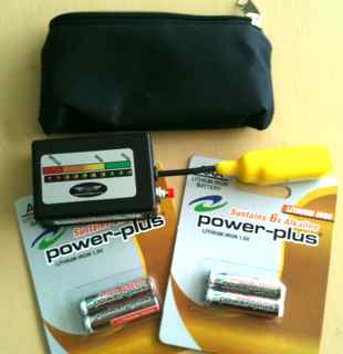

Postby ZULU1 » Mon Sep 19, 2011 5:31 pm
Ok, see what we have developed so you can check the battery level. Just plug in the pilots headset, press button and see how much battery life left. Comes with a pannier pouch and a set of Li Ion AAA batteries ready to carry in the plane. It also allows you to listen to side tone (listen to yourself with it plugged in).
Now that should fix it !!
Zulu1
Made for Chatterbox series at this stage
Battery Level Indicator.jpg (11.27 KiB) Viewed 1600 times
